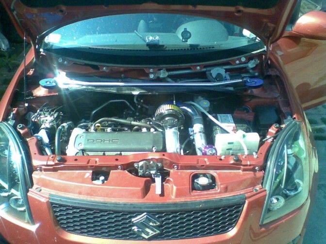

Complet Bolt on turbo kit 1600euro (this kit can fit M13A M15A)
oil cooler kit 200euro

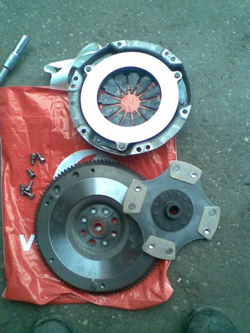

Perfect hungarian race clutch 200euro
Greddy ultimate engine managemant 450euro (but the greddy blue is enough and that is only about 250euro)
Greddy airinx airfilter 80euro
bompers and painting about 300euro
Sport suspension 200euro
sport seats 250euro
Whells and tyres 800euro
front strut bar 100euro
head lamps 250euro
xenons 150ero
steering whel 100euro
real greddy type-s blow 230euro
If you would need anything write an email, and if I can I'll help for you.

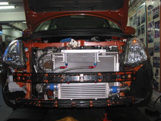

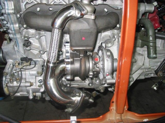

If you want a turbokit, i can sell you with better price. Here is a netherland webpage: www.dastecnology.com/index_fichiers/Page2124.htm
You can see they price is 3500euro + EMS.
My turbokit is same with that, just i my price is better. I can sell about 1600euro the kit and about 250euro the greddy e-manage +EMS.
The turbokit including:
cast exhaust manifold,
ihi turbocharger,
38mm Wastegate, (0.4 0.6 or 1bar spring)
300cc/min Denso injectors,
intercooler,
aluminium intake pipes,
stainles steel mid pipe,
stainles steel down pipe,
silicon hoses-T clamps
oil inlet pipe set,
oil drain pipe set with gaskets,
blow off,
3 way fittings,
vacum hoses,
high flow air filter,
3bar turbo map sensor for Greddy e-manage,
so there are everything what you need.
